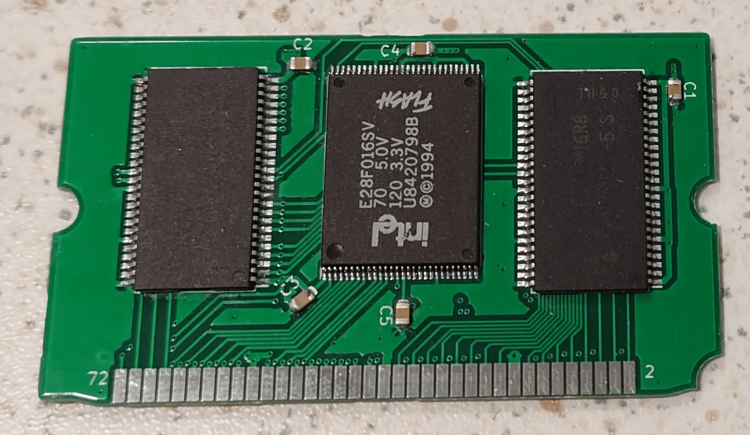

Description
This listing covers the DRAM-Plus-Flash Upgrade for eMate 300, the older “DRAM Only” style has been discontinued.
These modules are reverse engineered and redesigned eMate 300 upgrades.
It will increase your available System RAM to about 3900k and increase the DRAM bus width to 32 bits from 16 (this results in better performance).
The “plus_Flash” upgrade will increase the amount of internal program storage space in your eMate 300, to about 3600k total. It also increases internal storage bus width from 16 bits to 32 bits, for yet another small speed improvement.
