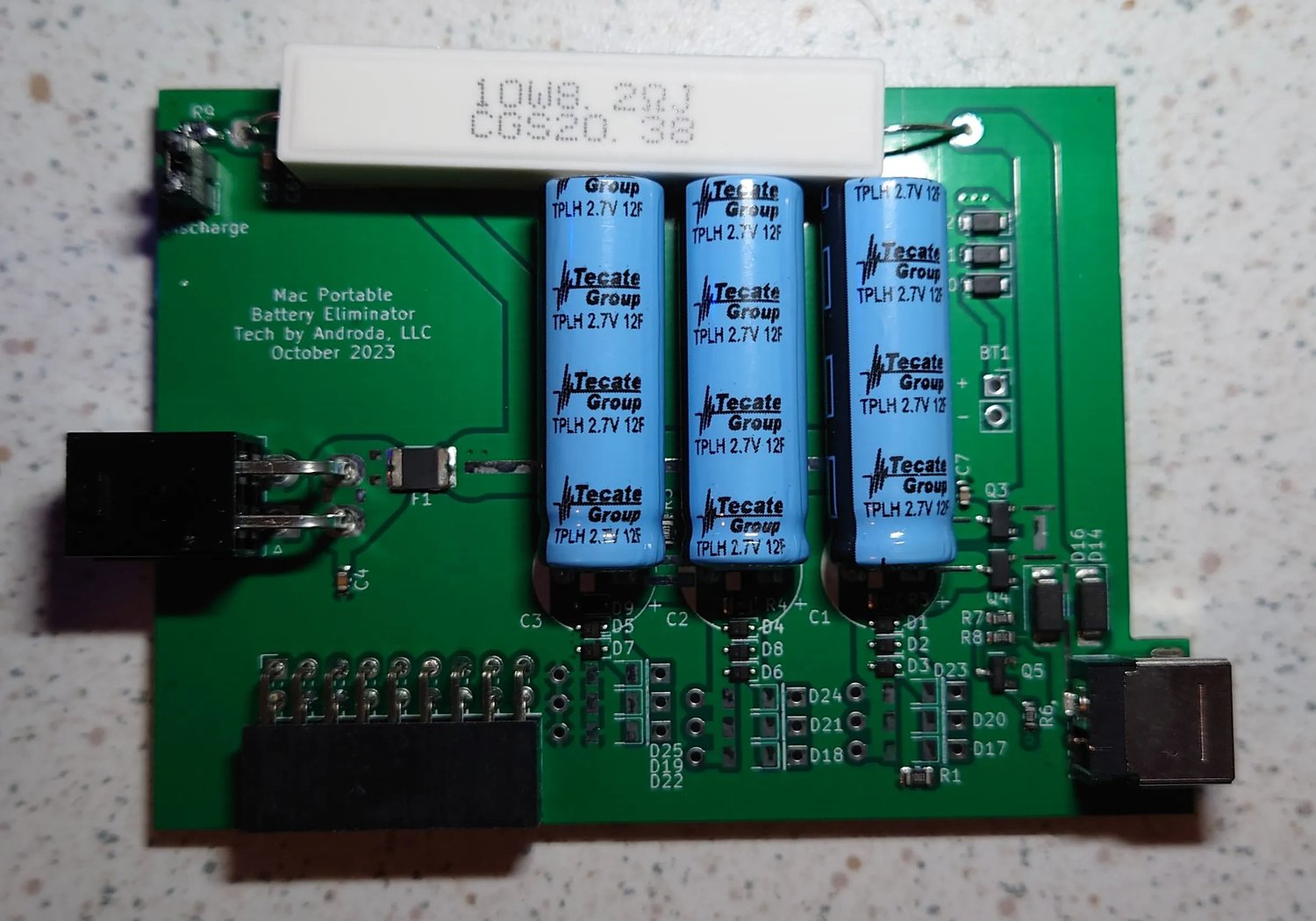

Macintosh Portable Battery Eliminator
Tired of keeping a lead acid battery happy?
Get rid of the battery entirely with this. For wall-tethered usage only. Currently this does not offer a PRAM retention mechanism.

This ought to let you use 7.5 volt power supplies of greater than 1.5 amp current capacity, as it fully replaces the battery. The Mac Portable has a 7 amp fuse to the battery, because the battery is really what runs the system. The original 1.5 amp supply is just enough to trickle charge the battery while booted with original hard drive running.

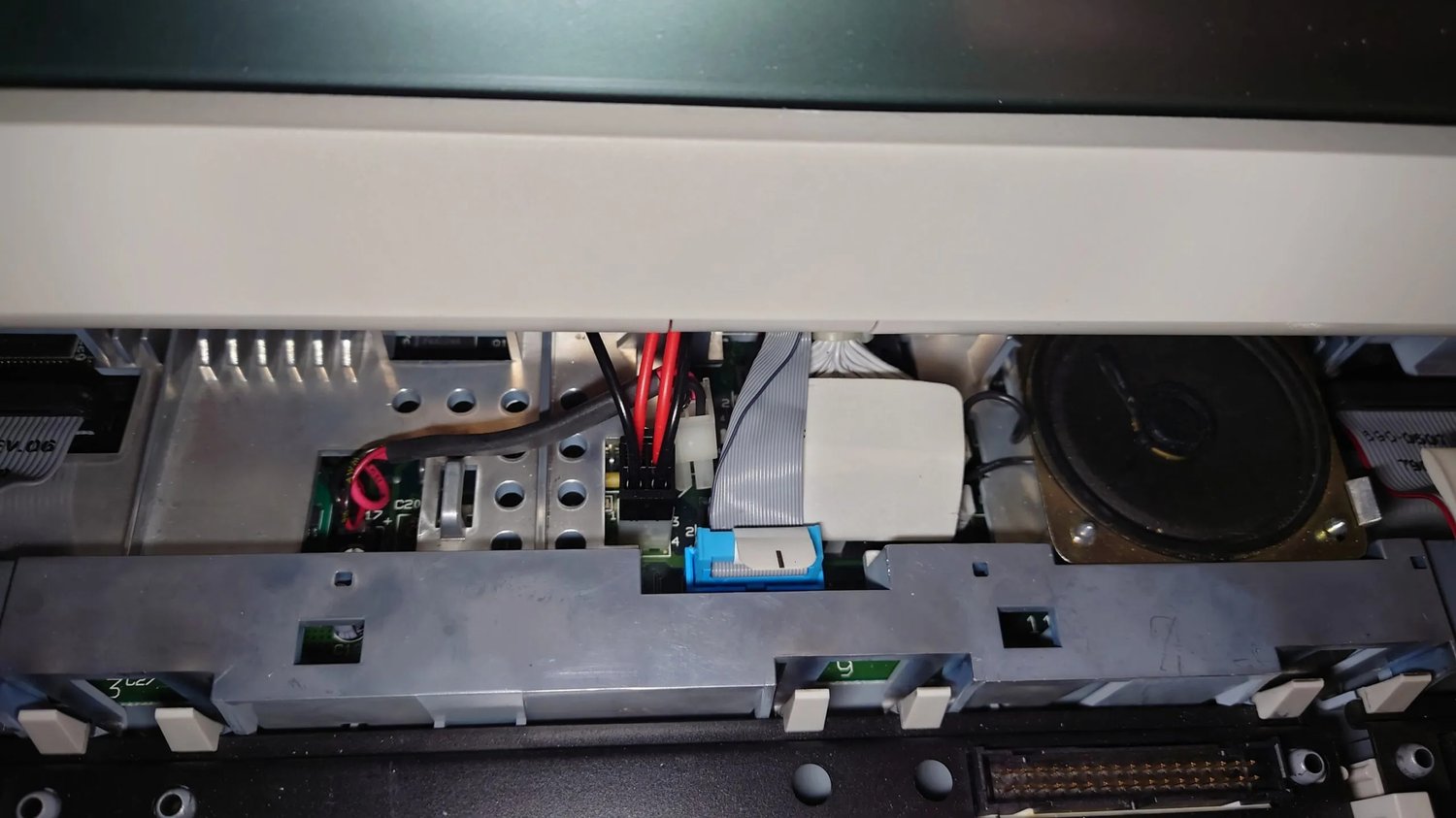

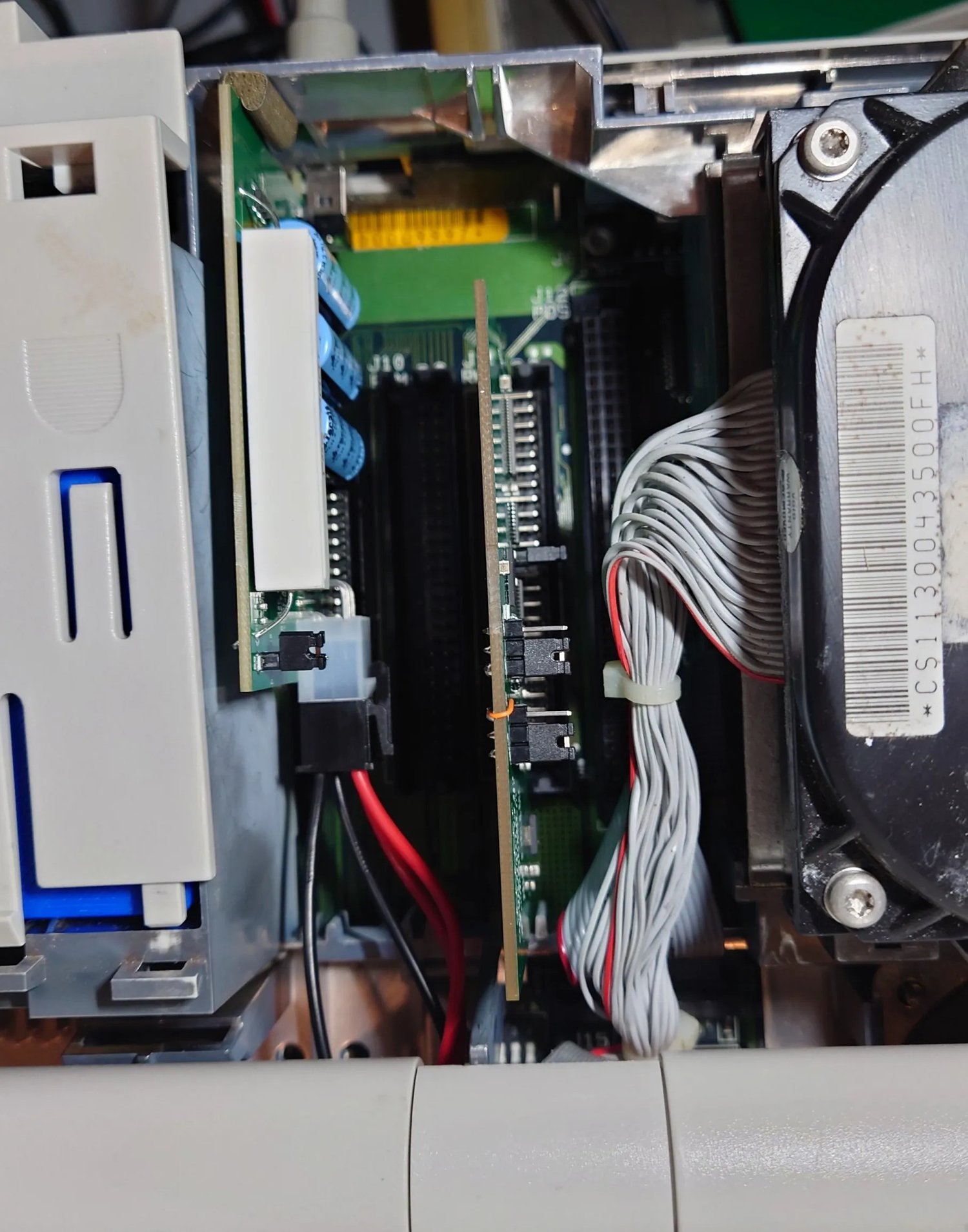

Installation And Use:
* Refer to product images, which shows the product fully installed
* Remove the keyboard shroud (this covers the display connector, SCSI connector, etc)
* Unplug the original battery harness
* Plug the included jumper cable into the motherboard and route under the display hinge
* Hook the jumper cable to the Battery Eliminator
* Plug Battery Eliminator into the Modem slot
* Plug Power Adapter into the Battery Eliminator (not the original DC in jack, which now does nothing)
* Wait about 1 minute and 30 seconds (this is how long it takes to charge the supercapacitors)
* Boot
